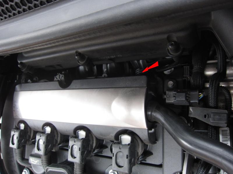

Continuation of the story:
- Fault P2263 appeared again at strong acceleration.
- The mechanic changed the turbo solenoid valve, but this did not solve the problem.
- Finally I discovered a small filter through which the valve takes ambient air. It was clogged. After releasing the air passage it seems that the problem is finally solved!
It is a rare filter, like rubber, small.
Some people clean it with degreaser, others remove it, and others, like me, make a hole in it. It's in a gap in the valve cover.
Photo of the filter position.
