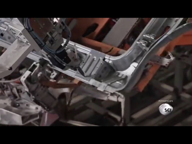

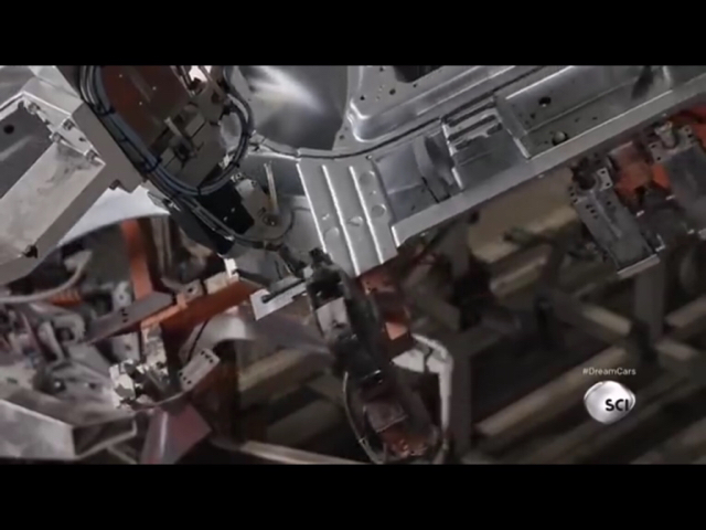

I too have just suffered the dreaded front jacking point failure. The second pic is the inside of the sill at manufacture. The bottom pic is the far stronger rear jacking point. To my mind the front point is in the wrong place and should be slightly behind where that strong box section is. My local garage have suggested welding a plate where the split is and cutting the tang on the sill by half to reduce the damaging leverage on it. Only trouble is now I'm worried about electric welding and car electronics. What a pain!
