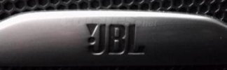

My first (no doubt of many) basic questions, 'cos I know nuffin about these gizmos.
1. From photos, I guess I have the NG4 3D - am I right?
2. JBL is a posh sound system - am I right?
3. I have the .pdf "PEUGEOT Connect Media Navigation (NG4 3D) MULTIMEDIA AUDIO SYSTEM / BLUETOOTH TELEPHONE GPS EUROPE - is that the right manual for my set-up?
Thanks in advance!

Yes, that is the NG4. There is a topic here for firmware and map updates.
I recently found 2018.1 maps (links are in that topic) and installed those and it's working fine so far.

Yes ng4.
I have ng4 with JBL as well, sounds pretty good.
