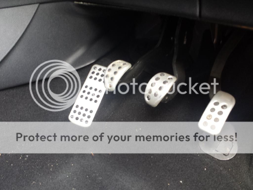

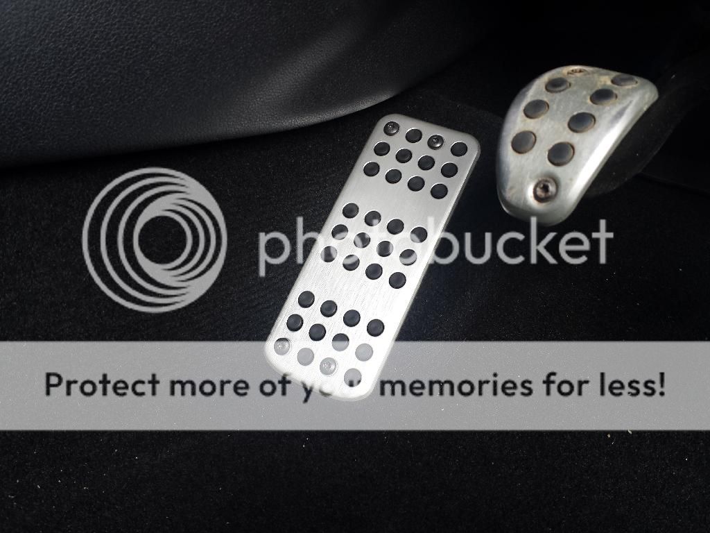

3) Using masking tape, position the footrest where you want it. I positioned it so it was about 5mm from the base of the carpet footrest and slightly to the right at the top (so I could get the drill in to the top left hole - others are easy to access). Note from the image how I positioned the holes, again to allow me to get the drill in (if you have it the other way up you will struggle with the top left unless you have a slim drill)
4) Carefully, using a 3mm metal drill, drill holes through the carpet/metal (there's not much material to go through so don't push too hard!)
5) Note that the screws have a special hex/star head on (I suspect it is the same as those used to secure the pedals so have a look if you have something that will fit these before you order - can highly recommend getting yourself a SECURITY BIT SET as they are MEGA handy, or you'll be disappointed when it comes to fitting!). Tighten using hand tools or drill/screwdriver on a low screw torque setting (or you will distort the alloy plate). It needs to be tight enough to be secure when wiggled by hand, but don't go MENTAL!
