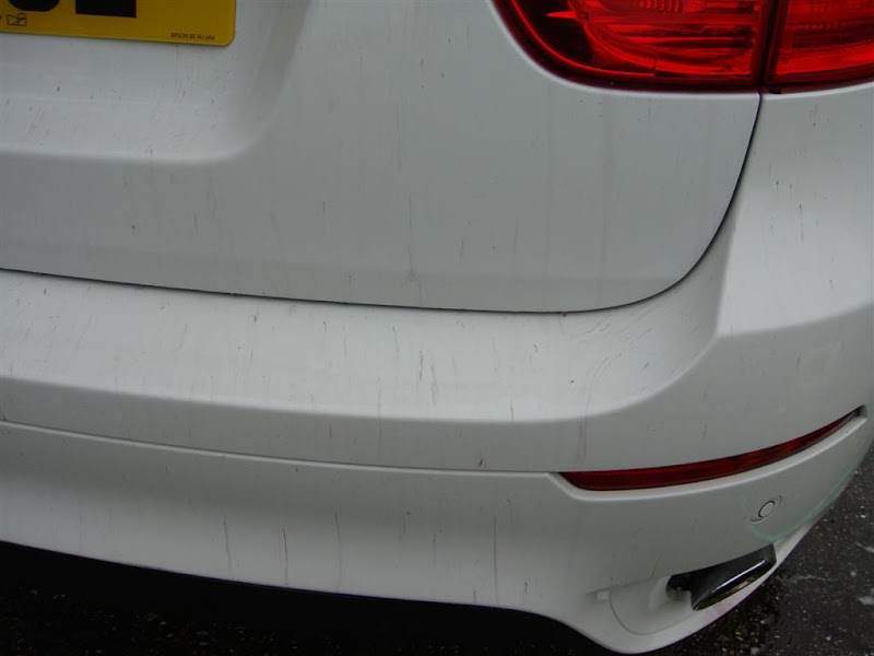

Ihave just washed my car for the first time after having it for just over a week and found a lot of raised little brown spots on the bonnet, boot and rear arches. If i scratch the raised spots off with my finger nail and try to wash off it leaves a spot that will not come off and is smooth.
The only way I can explain it is that it looks like there were tiny bits of metal on the car which they sealed in or landed on the car after they had put the sealer on and they have gone rusty.
Have any of you heard of or experienced this? :thumbdown:
What you are describing are iron filings / contaminants. All cars have them, even new, but they are more noticeable on white cars. If cars have been stood near railway lines for example or stood in compounds for a while, this is how they can be picked up, along with general air contaminants. You can buy products to get rid of these, Ironx - see link below however as you have supaguard on your car I'm not sure how it will work. There's a good chance it will reduce it the supaguard protection.

I use Ironx on my car, every time I do a full detail, which is about twice a year. Claying takes the top off, as you have discovered by taking the top off with your finger nails, unfortunately the rest is still imbedded in the paintwork, hence the need for Ironx. Don't be alarmed by Ironx when you come to use. After you have washed the car in the normal manner and dried it, you spray the Iron x onto a panel and leave for 2 - 5 minutes. All the iron particles on the car start to turn bright red and depending on how bad the car is, looks like its bleeding. As I said, don't be alarmed, just rub the panel with a microfibre cloth to get rid of the red marks and then rinse and dry, then onto the next panel, working around the car. There's was hardyly any on my car when I gave it its winter detail a few weeks ago, when using the Ironx. If you keep on top of it, they will be vastly reduced in months to come.

Thanks RCZ1, but I thought having the paintwork protected would have stopped this? I had another look this morning and it is getting worse.When it goes in to morrow to get the rattling dashboard sorted I will mention it and see if they can do something for me... :(

I've had the Gardx treatment and i've noticed the same thing, i thought it was insect droppings, or tree sap.
they seem to be tiny "blood spots" but slightly more of an orange colour.
I do find that Autoglym Super Resin polish will remove them, and the ones i've spotted are not under the Gardx treatment, as they do polish off.

I am sure they are tiny bits of metal, in fact I will see if they stick to a magnet and see what happens..
The iron filings will have been there before the Supguard was applied I'm afraid. I think I'm fair in saying that Iron x or the like has not made it into dealers valeters kit bags yet :!: This is why I bang on about professional detailers. They are miles ahead of anything a valeter will do. A valet and a detail are 2 totally different things. It's like the Premier league against the Blue Square Premier :eusa-whistle:
The iron filings / air contaminants are always going to adhere to the car ( any car ), even on a well protected car. It's a fact of life. This is why full details are carried out 2 or 3 times a year, to remove these and other sorts of contaminants. These all stop a car's shine from being at it's very best.
Jactac, yes they are like orange blood spots. I'm afraid polishing won't remove them fully, in the same way that claying doesn't. You are just taking the tops off. The Iron x draws them out of the paintwork as they are embedded. A magnet won't help either I'm afraid. Don't be afraid of Iron x, it does a great job and you only need to do it, once or twice a year.
They are strange sort of tiny specs that i can pick off with my nail then polish off the tiny bit of residue that is left behind.
Once i have polished off any remaining bits it doesnt seem to reappear, so i'm guessing these are on top off the Gardx and not underneath it.
I've only noticed probably 4 or 5 specs since i've had the car and all seem to have dissapeared after polishing.

Yeah they will adhere on top of the paint regardless of having Gardx, Supaguard, waxes or anything else on it. They will still be there but as I said, you have taken the top off them, so making them less noticeable.

I can't recommend Ironx enough and to be honest I don't get many on mine either. When I detailed my car for winter a few weeks ago, I gave it a blast of ironx and the contamination was barely evident. To my mind it's best to get rid of them totally rather than keep taking the tops off them. :thumbup:
