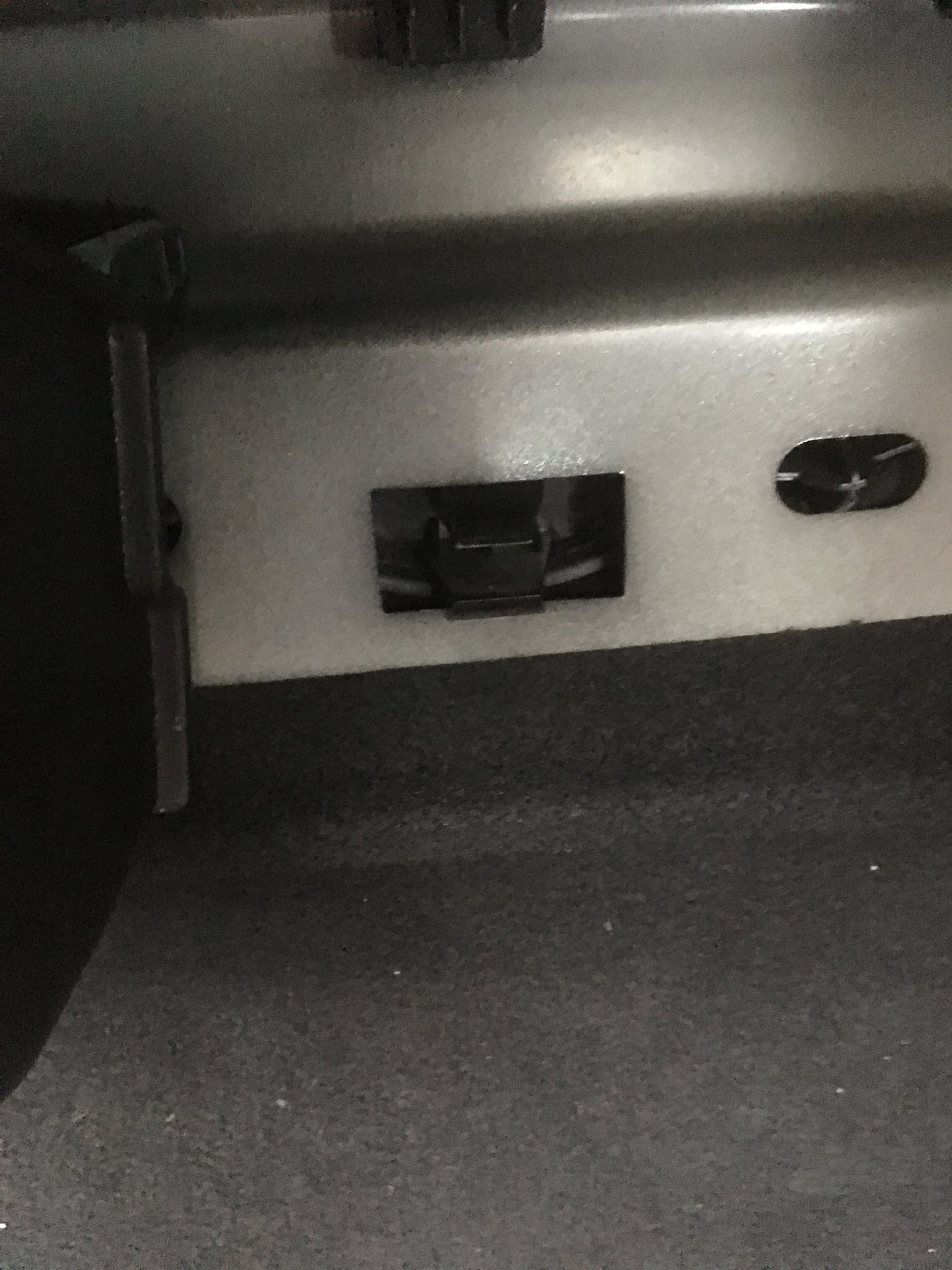

Now you are going to want to push the clips that hold the head rest in so you can just pull them up to take them off once inside the car.

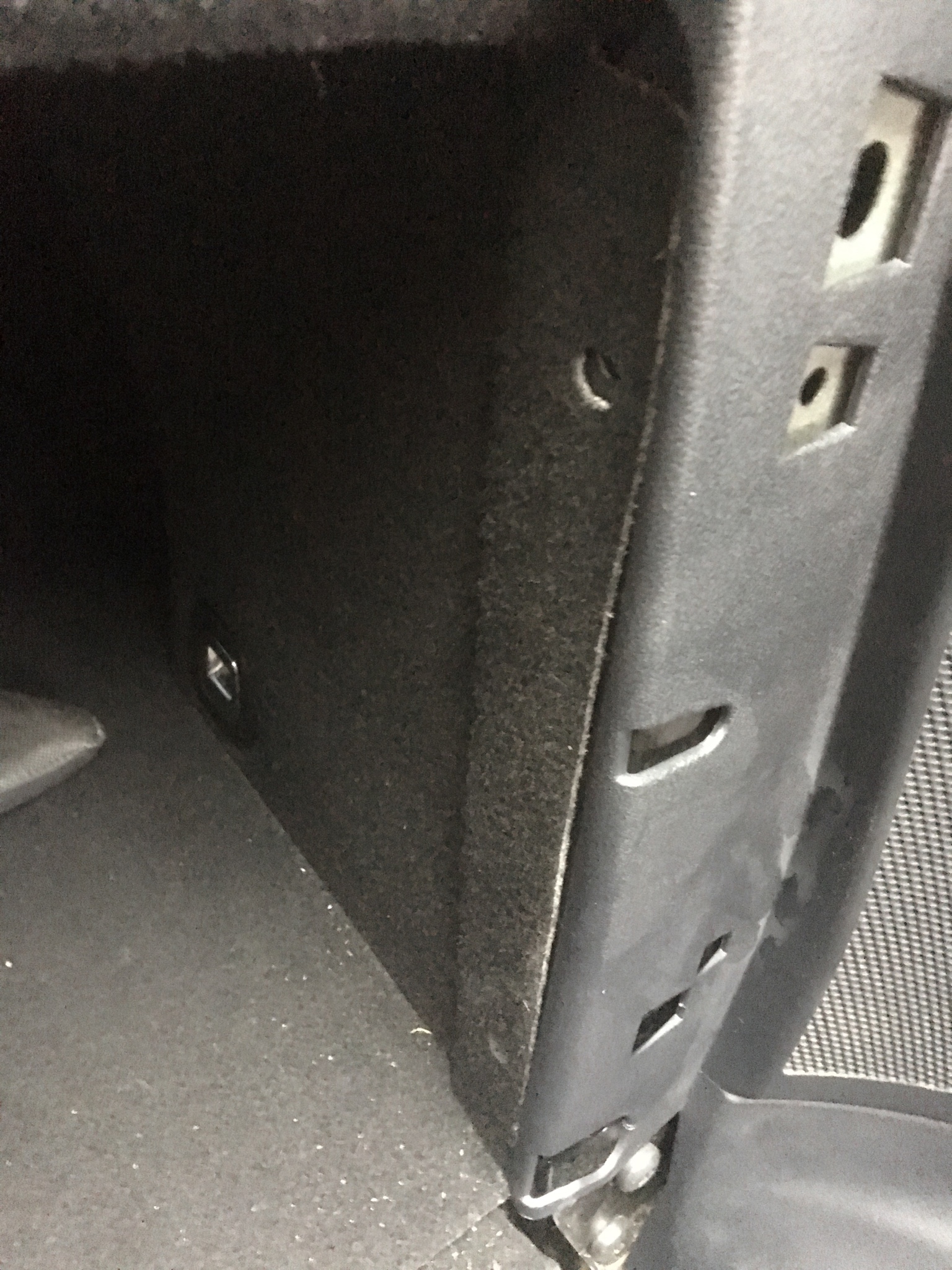

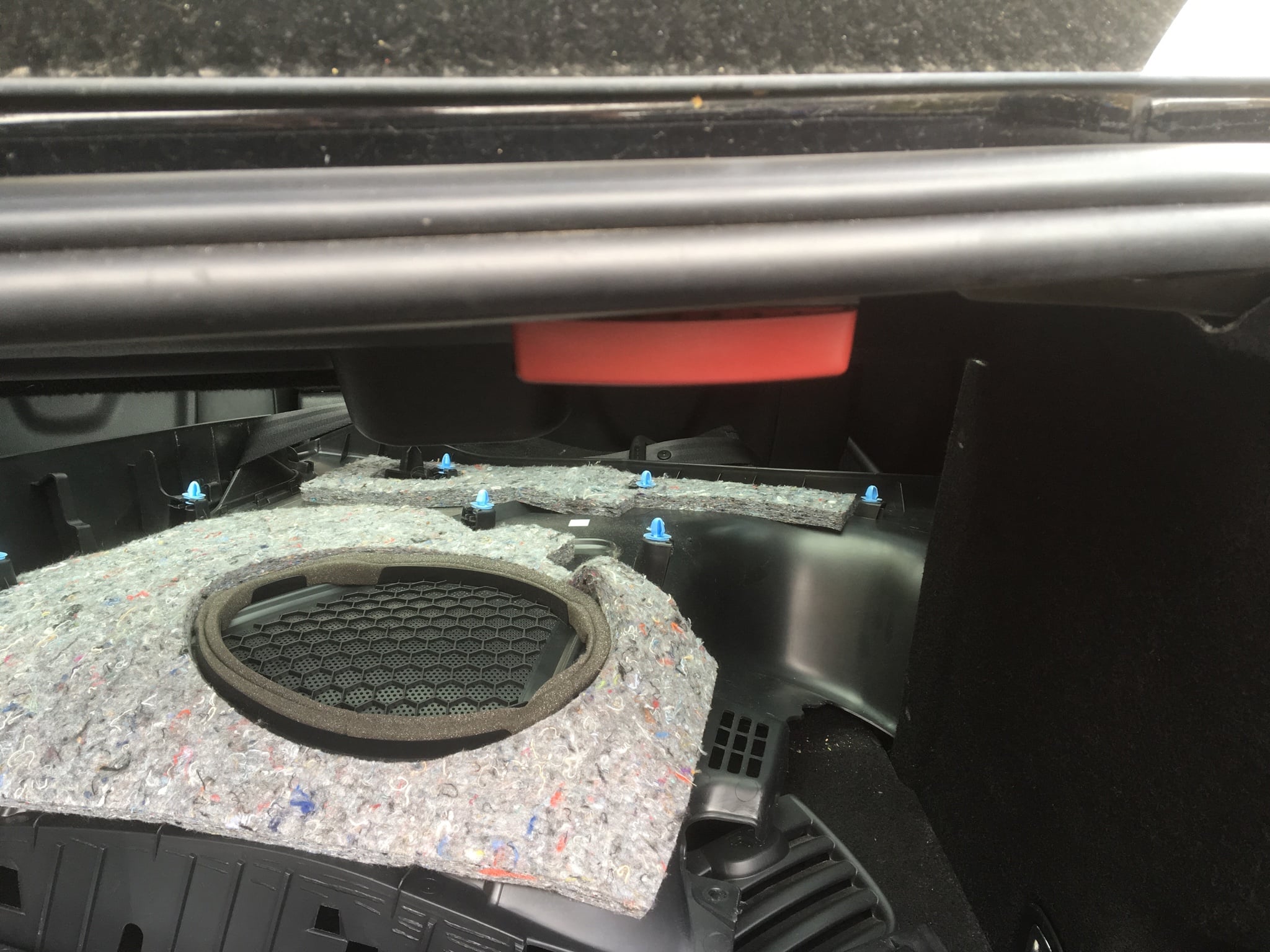

One more step in the boot to do now and it's the black plastic clips to the side of the boot(clips have already been removed in this pic)

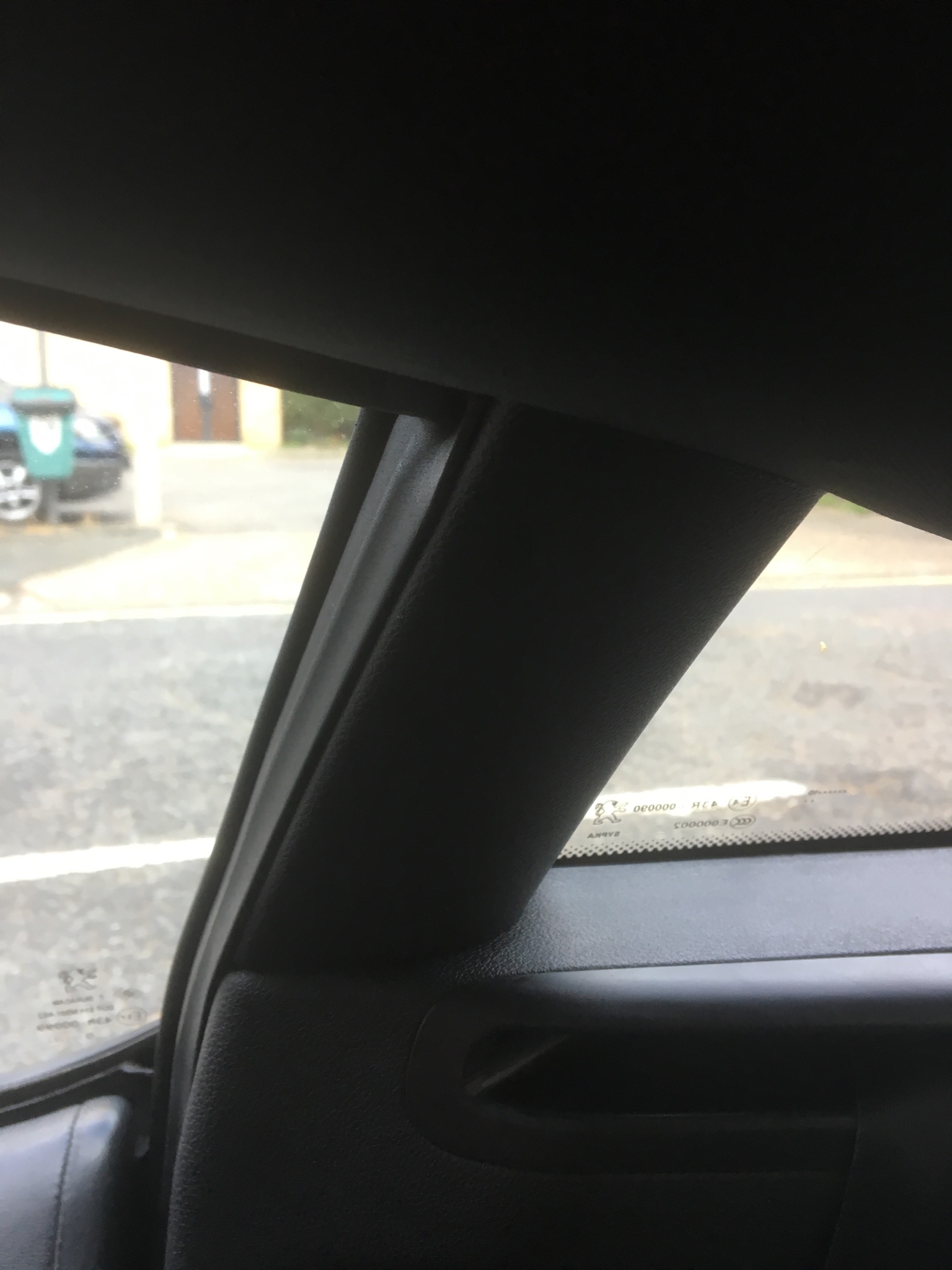

Using the interior trim removal tool,pry off the small plastic pillar cover on the rear window:

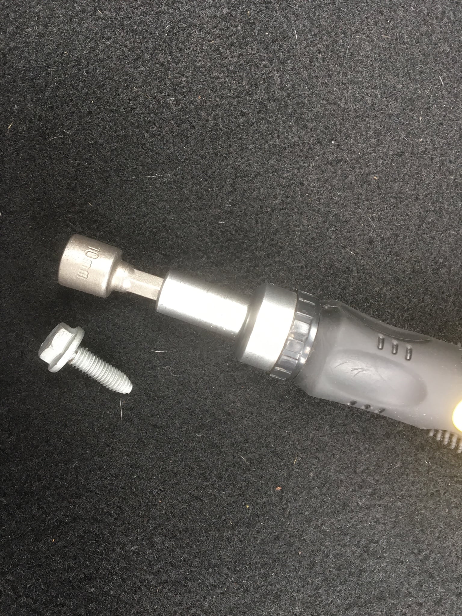

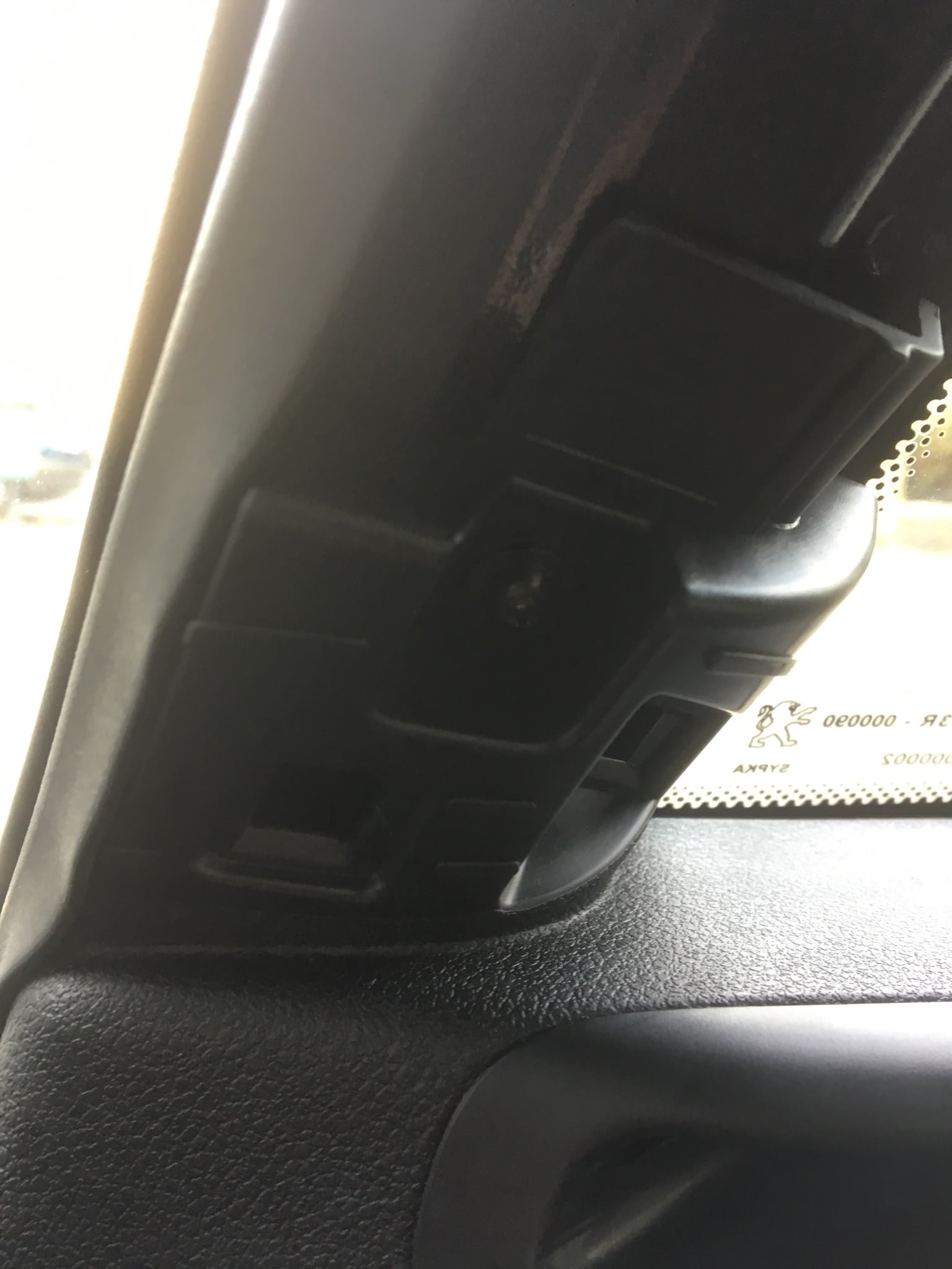

Now that's off you can undo the screw that's holding the panel on:

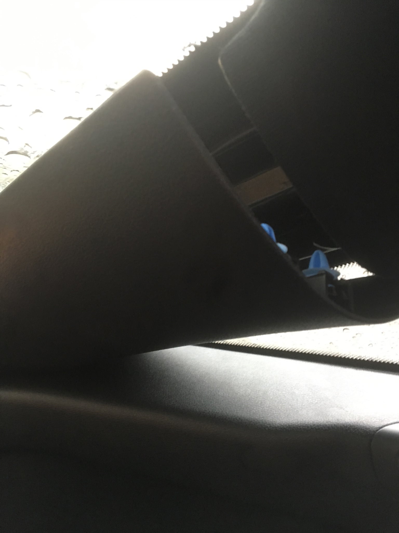

Loosen the roof pillar next,you won't be able to fully take it off yet we just want to loosen it for the moment for when we attempt to take the rear panel out.
Using our interior trim kit we gently pry it loose:

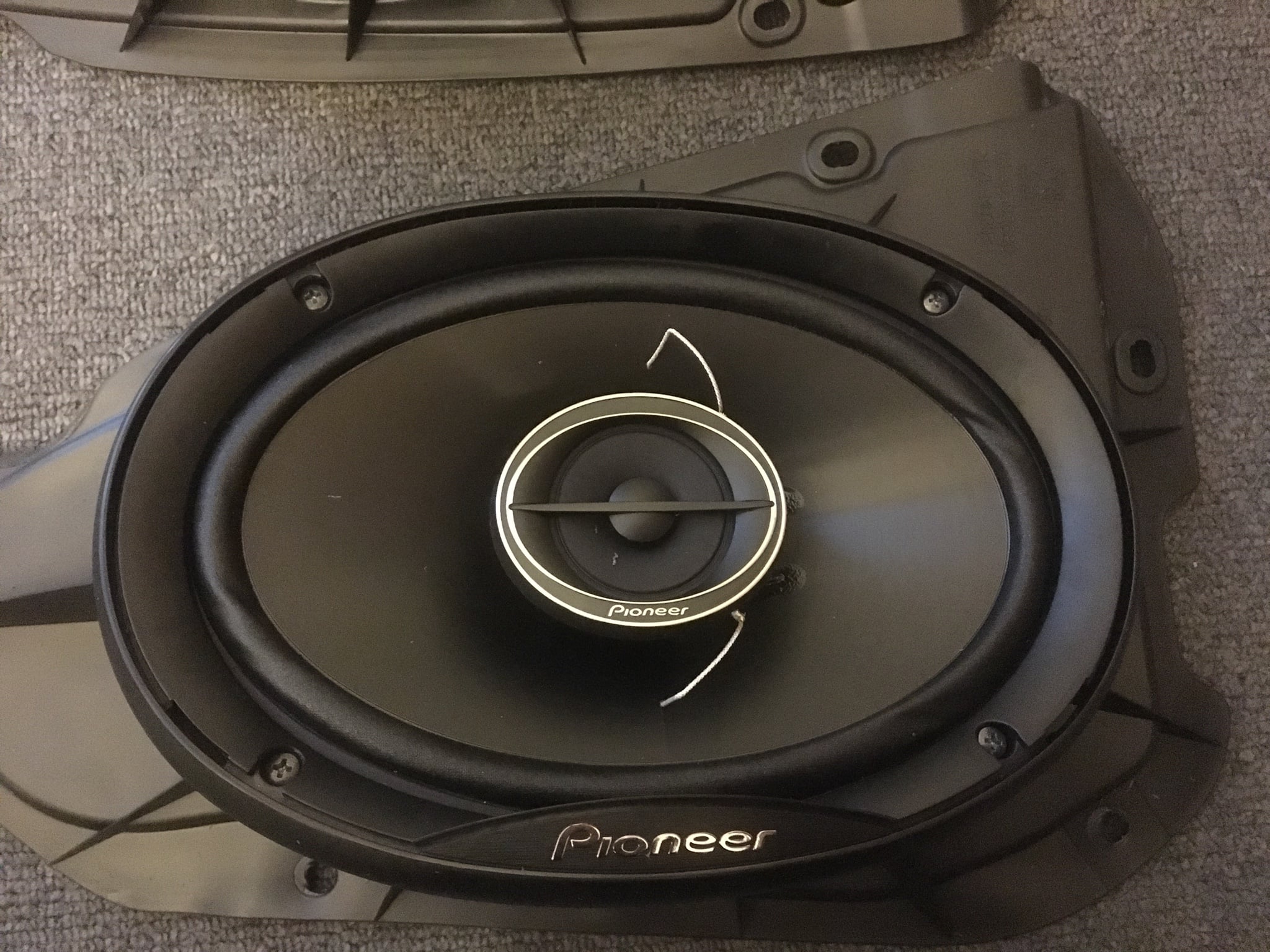

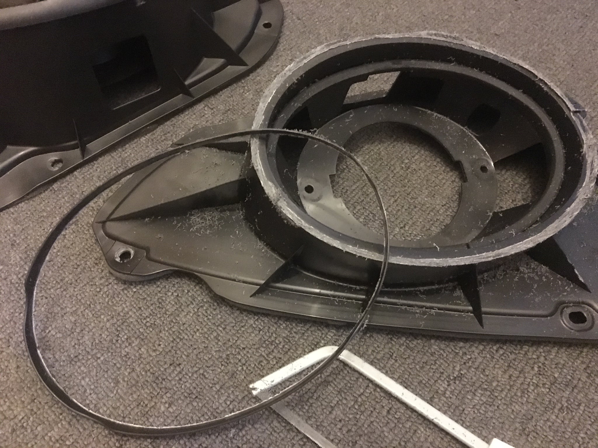

Now we've got the speakers out we need to trim a bit off the top(well in my case we need to anyway you may not need to do this)so they sit flush with the speaker enclosure and can drill the speakers in:
