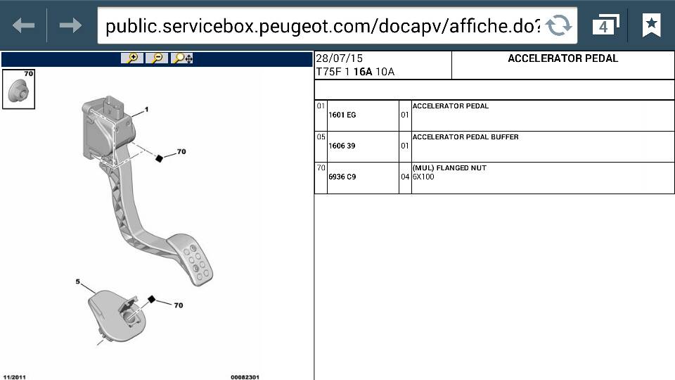

I've replaced the brake and clutch covers but can't find an accelerator pedal cover anywhere.
Peugeot web site says not currently available - with no idea of when it will be in stock.
Do you know where I can get one from?

And if you replaced yours did it require special tools?
The other pedals just needed a torgue drive and spanner, but the accelerator is boxed in at the back so the thread and nut aren't visible.

I think the pedal on the accelerator is part of the arm (intergrated).
Think people have drilled, then put cover over the top.
It was posted somewhere on here.

That would explain why I couldn't find a part number for it.

This is the assembly

I've had mine off. The fixings are plastic.
I replaced them with small screws.

The accelerator pedal cover is just scratched - not worn down on one corner like the brake cover was.
Peugeot didn't think that design through very well - ever heard of "maintainability"?

Did you replace the cover then? If so, where did you get the cover as it's not sold seperately? :?

I just polished them up a bit.
