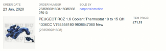

Most likely thermostat housing, mine used to do that
2,588
810
Bought form Ebay fitted on my 200

Did it lose coolant though? or does the crack/flaw just affect the pressure? I havent had any coolant loss.
No didn't lose coolant, mine just used to fluctuate alot so had it replaced and sorted. If you have the 200 make sure u get the correct thermostat as its different to the 156 thermostat

Depending on Model or engine code they upgraded the connections ( longer tails) on the thermostat housing on a 200 & R the plug goes directly into the tanks rear socket on the new design for the 156 the tails have to reach further to their connectors as the sensor is in a different position now
The temp sensor is inside the housing so its all in one
Labour costs may be at the high end as its not a quick bolt off & on job as the Tank is underneath engine loom wiring carrier below the air intake & turbo hose the battery has to come out all intake pipework is off coolant is drained & coolant hoses disconnected
