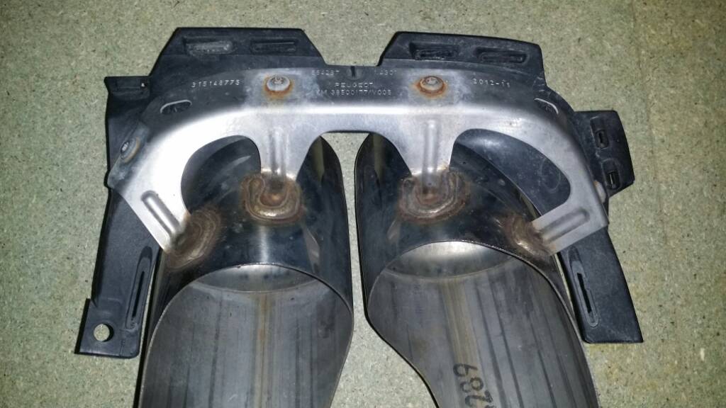

The original exhaust trims are held on with tags to the bumper.
Just have to get in there and tweak the tags to loosen the exhaust trims.

I'll take some pics of my trims so you can see where the tags are.

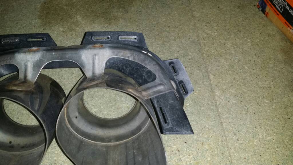

It's the 4 tabs on the top and the 2 on the right side going down.
There might be 1 on the left as well. (Last pic)
I undid the 4 screws to be able to remove the metal trim with a bit of a struggle to be able to see/undo the tags.
When I replaced the valance I found the putting the metal trim back on first and then working around it to put the tags back in the slots which held very well as it was months before I actually fitted the quads.
