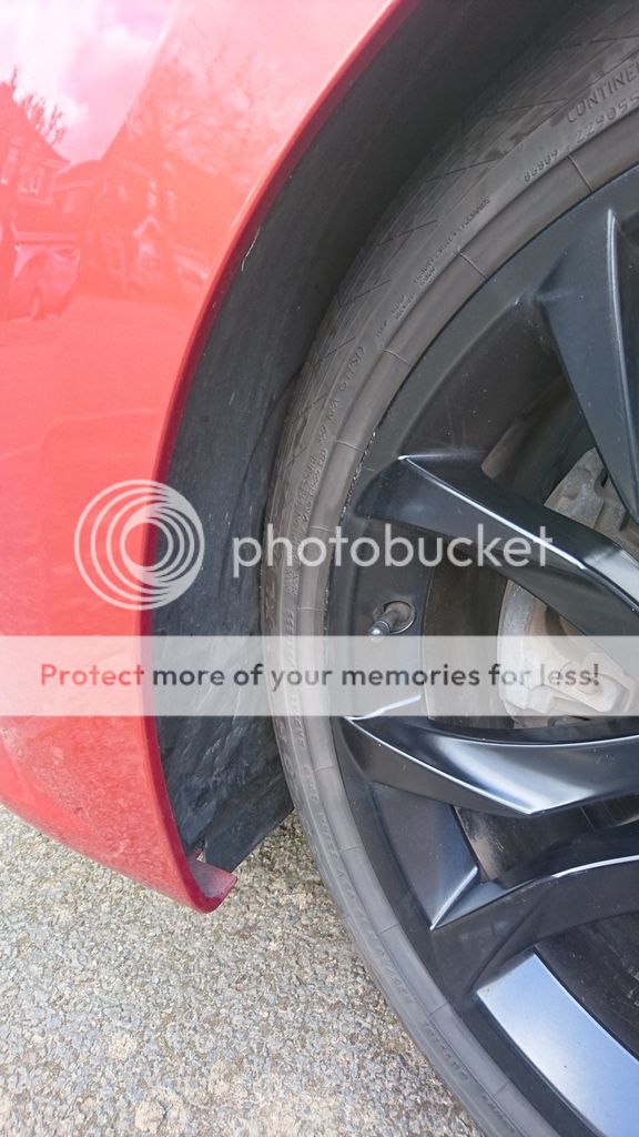

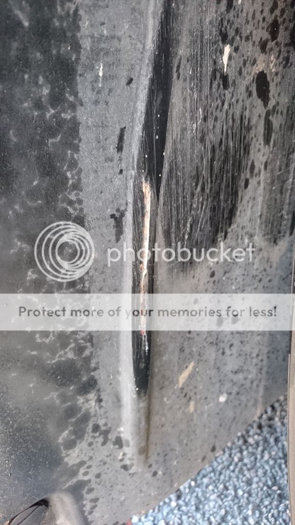

I've got a bit of an odd problem that two Peugeot garages have failed to locate the cause of so far (might try a third soon).
When turning right my tyre is catching the middle of the wheel arch liner towards the cabin. It has managed to wear through the plastic to part of the bodywork metal, and seems to have sharpened the metal. The passenger side also appears to be catching on the wheel arch liner towards the front but luckily there's no metal behind that one.
I'm on standard 19" sortilege alloys and continental sport contact 5 tyres. The passenger side coil spring had failed, extended warranty covered it and I paid extra to get the drivers side coil spring changed at the same time. Changing these has not sorted the issue.
I have owned the car 3 and a half years, and only noticed this within the last month. The tyres are almost on the minimum, so it's only going to get worse when the new ones go on this weekend.
Anyone had anything similar and worked out the cause?
Does anyone have access to the service box suspension diagram that they could share?
Any help would be appreciated.
1,843
283
I don't know why that's happening but hopefully somebody here can help.
It doesn't look good at all from the pics though and TBH it looks pretty dangerous to drive it like that to me. :wtf:
Surely somebody at Peugeot Main Stealers should know what's going on?! Crazy!

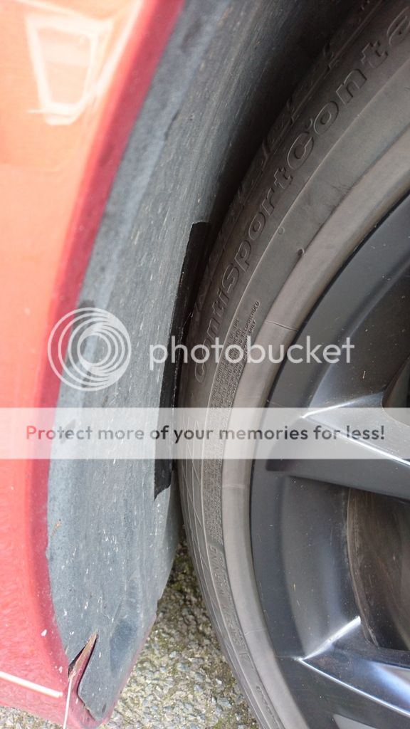

That would happen if you were using oversized tyres - but It looks like 235/40/19 in the picture. Check and make sure there are no spacers fitted on the front wheel - especially if fitted one side only.
5,094
Well that’s not right is it! It never fails to amaze me that Peugeot’s own dealers can look at something like that and stand around scratching their heads. :eusa-think: :?:
It’s not rocket science that the distance from the hub to the inner wheel arch isn’t correct. If it was, like every other Z out there, your tyre wouldn’t be wearing the wheel arch liner down, and the wheel arch liner wouldn’t be wearing the tyre down.
I’m no mechanic, but I would have thought; measure the distance from the hub centre to the inner arch, then compare that to a Z that isn’t dodgy & then work out a solution. I.e. move the wheel arch liner until it’s not making contact with the tyre edge on full lock.
I would also be wanting answers as to why it was like that in the first place, and, unless the car has had some kind of front end shunt during its lifetime, I think I would be asking for a contribution (at least) to the cost of replacement tyres.
The repair should be FOC of course.
Just sayin :eusa-whistle:

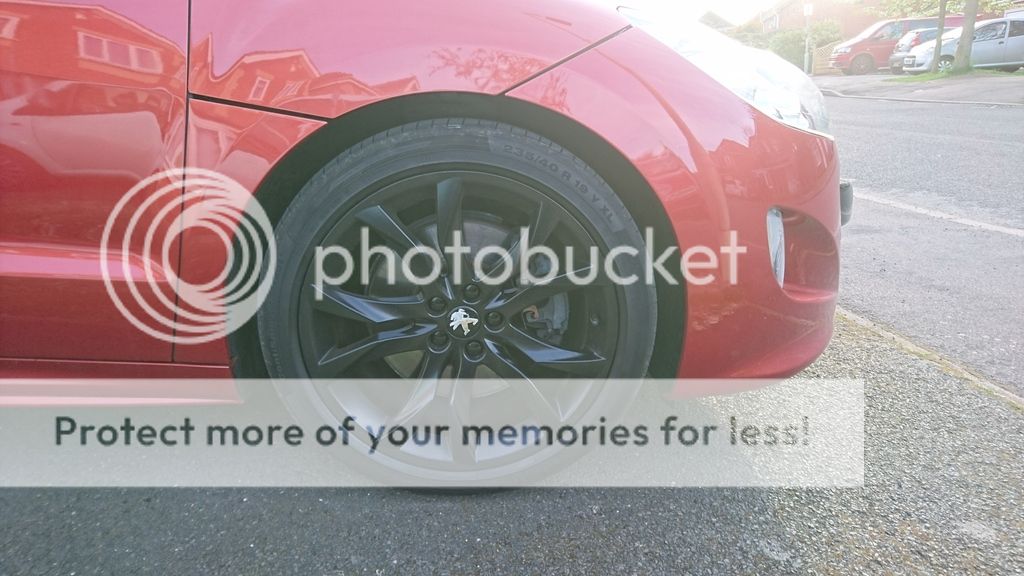

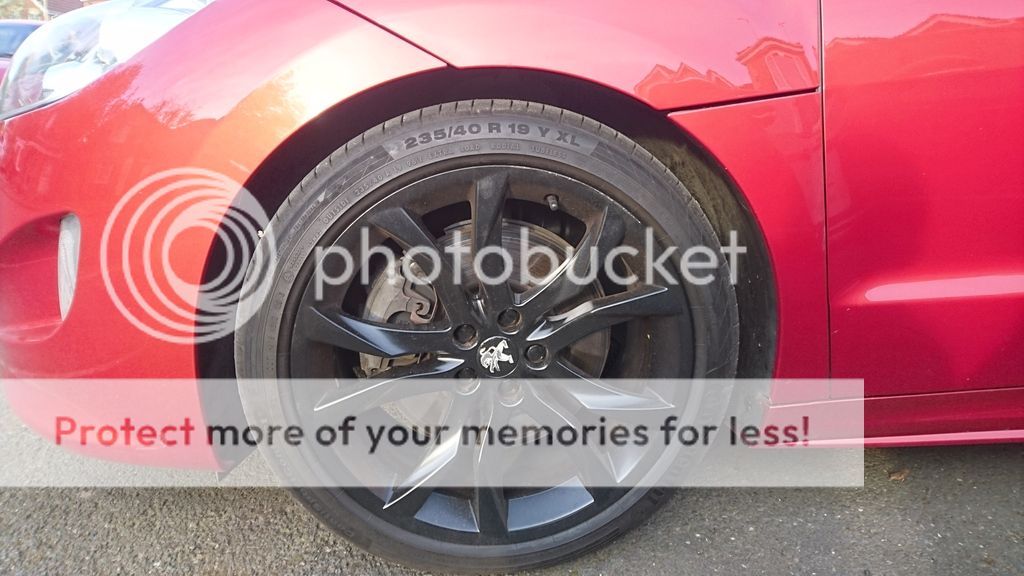

Thank you for the replies so far. It's definitely made me nervous taking corners at any speed. First garage said they couldn't see anything wrong, including saying they couldn't see anything wrong with the tyre that has cut marks down the edge!
Here's passenger and drivers side pictures, seems to look ok when the tyres are pointing forward.
1,297
Looks alright side on, what about the toe of the wheel?
Mine certainly doesn't do that amount of scrubbing, and I'm guessing from the responses neither does anyone elses.
So there must be an issue.

They couldn't find any alignment issues. It looks like the rear tyre has been catching the liner too.
The car appears to be sitting lower on the drivers side at the rear. Going to find a flat car park to check better but starting to think the drivers side rear shock could have an issue. I did have the caliper seize a few months ago, maybe that corner dragging has done some damage.
peterma
Oct 17, 2014
Took it to an independent garage who said the wishbone bushes have failed. Getting them replaced this week and hopefully it stops the rubbing. If it does I can't believe two Peugeot garages couldn't spot this; only took the independent garage around 5 minutes of looking at the car!
