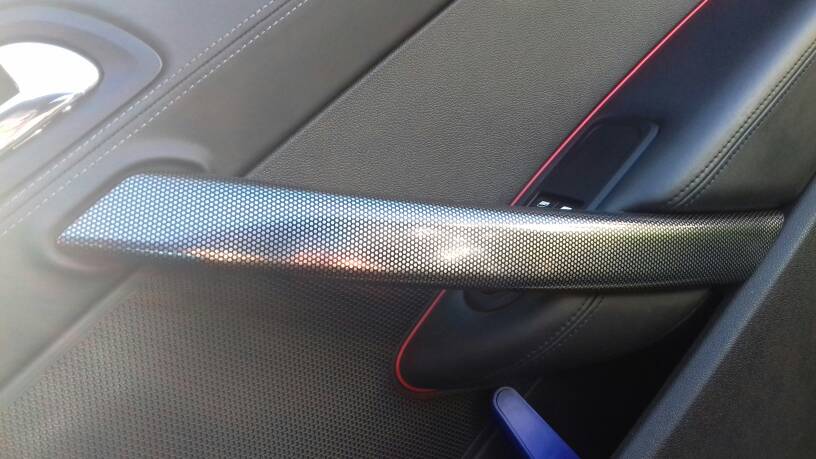

Your inner door handle surrounding is covered like most of the black plastic in your Z, in a rubberised black paint, I also had some scratches off the previous owner, so first I tried wrapping them which looked ok but then I got bored with the look so I peeled all that rubber paint off and sprayed them myself , they now look factory fresh with the added bonus of if you catch a nail or something on them they do not scratch happy days.

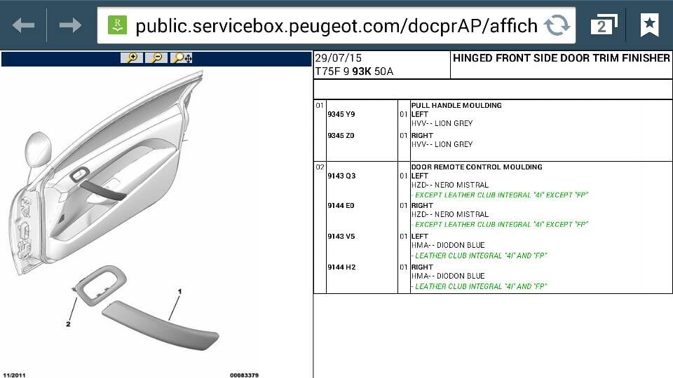

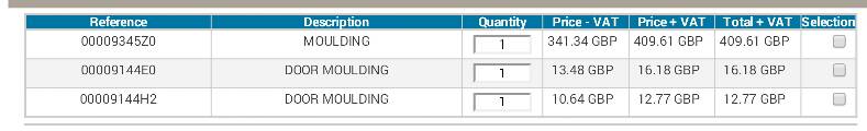

Just had a look on the Peugeot system and got this info.
Did I just read that right? £491 inc vat for a bloody door handle!!!! :crazy:
Hope the breakers don’t see that!
No you read it wrong.
£341.34 not inc vat
£409.61 inc vat.
See not as bad as you thought![FACE WITH TEARS OF JOY]
Thanks for all the tips guys, yeahhh I didn't think it'd be +400 quid for a door handle :wtf: :wtf: Maybe not that option ! I think I'll probably go with the wrapping route and plastidip :D

Yes they’re quite tough to get off it’s just the silver part that splits from the handle use a plastic trim removal tool and work from the top when you get near the bottom there’s like a plastic clip that goes through a hoop so you have to release this don’t just pull or you’ve a chance of breaking the clip.0564E67A-0BD4-4B86-9C30-F158D2D6BAF0.jpeg
