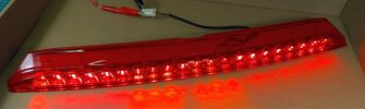

So I bought a used high level brake light off ebay for 60 quids - half the LEDs were dead. It is ultrasound welded plastic so I cut it open with a Dremel diamond disc then replaced all the dead LEDs and some flickery ones as well. Resealed with red silicone sealant, I then swapped it for the half lit unit on my 2011 RCZ.
Having fixed that one, I then fixed the one I took off the car in the same way.

ps - I've been in electronics for 50 years. The LEDs are all soldered on properly.
The red sealant is not visible at all when the unit is on the car
side note - The LEDs in these lamps are thrashed within an inch of their lives to
get the brightness. People who sit on the brakes at the traffic lights instead of using the handbrake mean these little chips are getting very hot indeed. Worse on a hot sunny day. That is why they die. It is a miracle they last for ten years, but it is awful that Peugeot seals them so they have to be scrapped. £180 for a new one is a bit outrageous.

PS: I beat seven bells out of this circuit board before I glued it back together.
Found a cardboard box for it and ONE LED FLASHED!!
I can't make it flash again. I'm not taking it apart again. The rubbery silicone will be much
harder to get into than the hard plastic weld.
