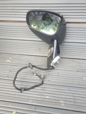

So I’ve written a couple of posts now asking for help and suggestions regarding a broken spoiler and wing mirror on my new rcz. Thanks for all who have offered advise and suggestions. I thought I should put some pictures up to show what’s happened.
I thought I might be able to get away with bonding the bracket of the spoiler that has broken, but after taking the boot carpet off and inspecting the underside of the mechanism, it seems no amount of gluing will fix this! So next step will be eBay for a new mechanism.
the wing mirror appeared to have taken a knock at some stage and would not fold when locking the car, although you can see and hear the motor trying. I disassembled the mirror housing and found that it had broken at the shaft and the previous owner has ‘fixed’ it in place with 3 screws, preventing it from moving. So off to eBay again I guess! In the picture you can see where the screws were driven in, I forgot to take a picture of it before I removed them though.

Wow looks to me like vandal damage I can’t see this ever happening in normal operation especially with the spoiler, there are loads of these units in breakers and they’re not too dear at the moment, wing mirrors on the other hand are around £250-£300 for a secondhand one!

Looks like someone has tried to pull the spoiler off when it wad up or someone else has sat on it or it wasn't going all the way down and the previous owner was a bit heavy handed and tried to push it down to hard.. Wing mirror might have been broken in car park but will be costly..

Saw this one earlier toda, am watching. The only problem is it’s the wrong colour. im going to have to get it sprayed £££ or maybe I’ll pop down to Halfords and get a small can and try myself. I mean, how hard can it be??? 🤔🤣

i agree, it does look like vandalism, it’s as though someone has pushed and pulled it with some force because it’s very thick reinforced plastic. Thankfully that’s the cheap bit to get hold of.

Yeah thanks for that Pedro. I’ve been looking at tutorials on YouTube 😬 I wonder if maybe it’s possible to take the insides of the shaft out and swap them over? That means I could use all the outside bits from mine which are the same colour.
