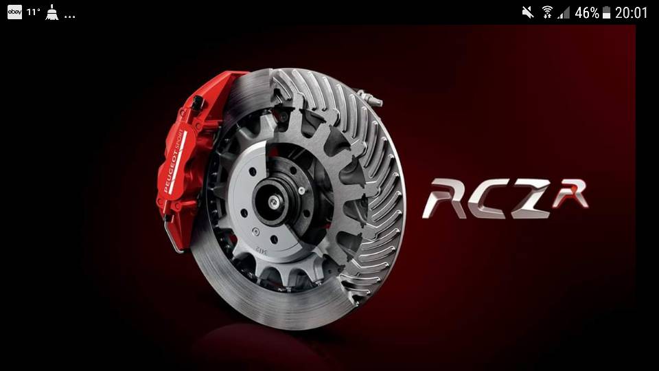

From an RCZ r forum...
Sent from my SM-G930F using Tapatalk
998
128
this is how they look like

I have seen Alcon 380mm rotors without the bells. The R brake does not appear to be able to be seperated as alot of the other Alcon fitments do. It will be interesting to see if a seperate bell and rotor combo becomes available as the cars get older.. We could all petition Alcon to make that a possibility.. lol. I reckon that Peugeout have done this deliberatly to keep us coming back to the main dealers...

The discs cannot be separated from the bell. It is an one-piece part.
@Docksey007
You can try the 308 discs on your R. Before that I'd check the wheel hub (is it exactly the same as on the R?), the PCD/hole and then order them.
When it comes to wear-off indicator for those original R discs, there is a minimum thickness in mm printed on the disc. When you take off one of the front wheels you will see it. It is pretty in the middle of the disc, hidden by the rim. If I recall correctly it is 30mm
