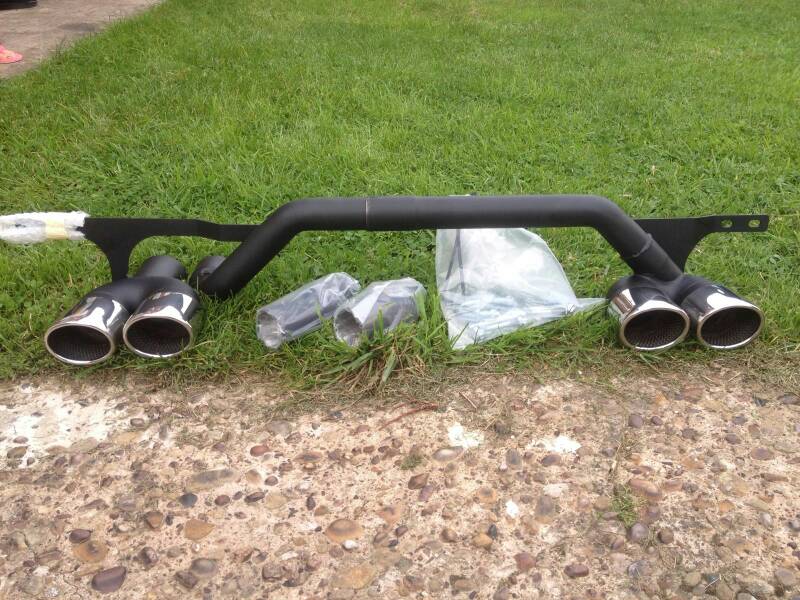

This is the Zunsport quad exhaust.
The buffer between this and the tail pipes from the back box are just a wire wool sock.
When I made mine the wire wool sock were spot welded to the original tail pipe which had to be shortened. I cut off the spot welds and re - used the socks.
