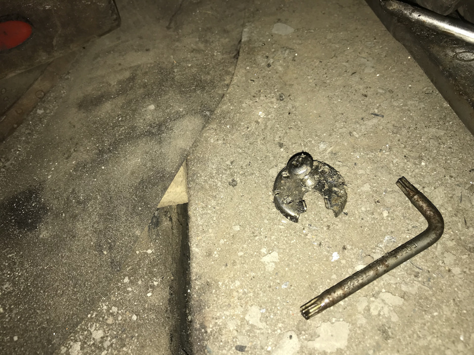

Searching for the part number I found this:
Запчасти на фото: 2029002. Фото в бортжурнале Citroen C4 (2G)
There pictures are for a Citroen C4. Is all the wheel shaft removal necessary?
