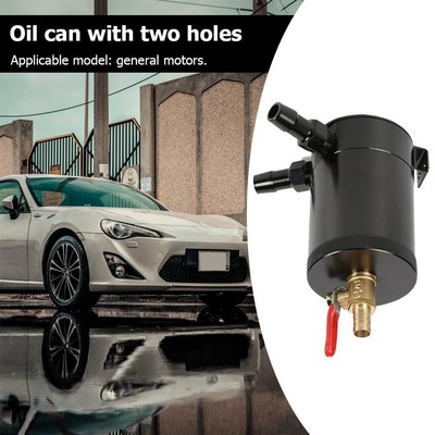

I've ordered one and I'm going to fit it to my 156. Thing is I now believe you need to fit two... one on the vacuum side (left) of the engine and another on the boost side (right). I'll fit the boost side first then look to fit the vacuum side.
Here's the link to the one I ordered... it's baffled and has a drain valve on the bottom.

Whether the oil is fresh and clean or dirty what gets collected in the catch can, I believe, is the 'blow by' (gases, oil & fuel) which is ventilated by the PCV and recirculated through the cold side of the turbo, on into the inter-cooler, and into the inlet manifold via the throttle body. Some normal 'burn off' will occur with this gunk but I've no doubt it also contributes to carbon build up on the backs of inlet valves and it can't be great for the turbo, inter-cooler and throttle body either I recon.
From the videos I've watched these catch cans seem to trap a lot of oily mess or gunk so I'll install one (or two) and see how I get on. I'll report back in time with what I find 👍 :)
