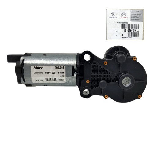

A new motor will not be cheap! There is used one for sale on ebay in Italy, and I possibly may have one. I will have a look today and let you know if I do.
Thanks!
I assume u did not find it(
yes, saw this lot as well, also, contacted local dealer in Kyiv, the new one will cost around 400 eur or smth. Seem i’ve seen the whole used interior for similar price:)
Nevertheless, still keep looking for it, maybe will find smth for a decent price. Still it is not a 1st type necessity considering that tilt can be adjusted manually with pliers when needed…
Still, hope that something come up sometime.

Yes, I have one, part is still attached to the frame.
