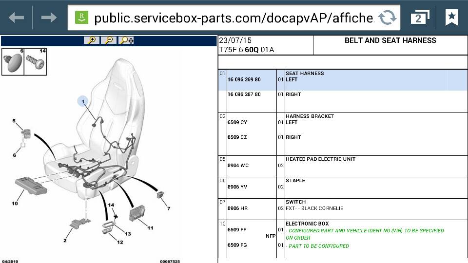

PM me your Vin number and I'll check the Peugeot service system, and also check with mine as it has electric seats.

VIN: VF34J5FV8CP007034
These are for your Vin number.
So you will need access to PP2000 (the Peugeot service system).

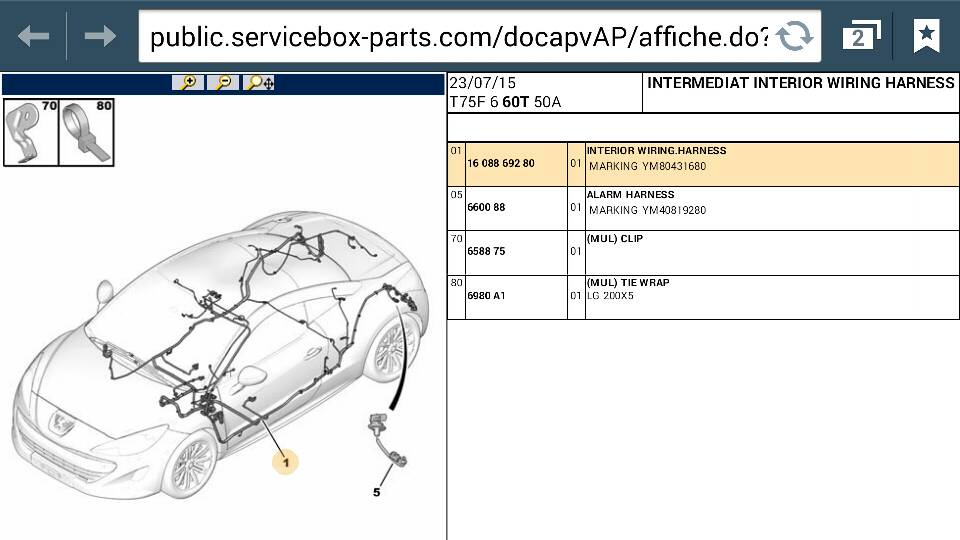

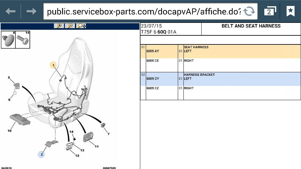

From what I can see the wiring is in the seats, whether it will be able to connect into the main central harness is another question, but I would have thought that the harnesses would be the same (central ones) as they have the same part numbers and markings, it would also be cheaper to produce one harness then several options.
As to the PP2000 - probably would need to re configure some items, but would have thought if the seats plug into the harness then the seats should heat and move, but the memory settings and mirror memory is the thing that would need configuring.
