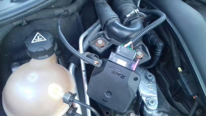

Yes they updated them there use to be just two sensor connection points for the RCZ but now there are three points to connect some thing to do with improved performance of the chip, as for installation not that difficult the only tricky part was removing the air filter box to access one of the sensors other than that straight forward, as for performance gains the car definitely pulls better and you certainly feel the surge when the turbo kicks in a lot more than before, I enjoy overtaken even more now, they say 30+ bhp gain, i would have to take it for a rolling road test too see exactly what the gains are but it definitely feels substantial and I have no complaints so far, I haven't had time too try any of the other setting on my RS CHIP yet, maybe when the weather improves I might have a play.

Maybe Stu8 would consider posting some pics showing where the correct connections are located?
Would be very useful for future buyers. :thumbup:

This is for everybody to know the correct wiring procedure - cable marked GREEN goes to boost pressure sensor. Cable marked RED goes to manifold intake sensor (under air filter box). Cable marked blue goes to air flow sensor. So if you're looking straight at your engine it's green on the left, red under the air filter box ( center ), and blue to the right hand side, hope this helps a little.
