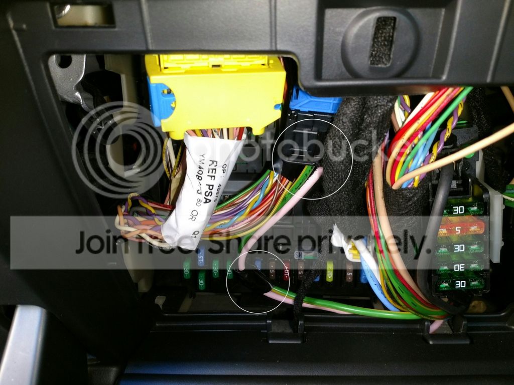

Fuse box picture.
The lower circle are two wires that look like they have been cut as they are now connected with electrical tape which then leads to a connector. Is this likely to be part of the hard wire?
724
I wouldn’t have thought that is what your looking for :eusa-think: the wires are way too big. If the feed is from the fuse box then most probably the wires from the cam are fed behind the left hand window pillar trim try checking there :thumbup:
