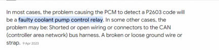

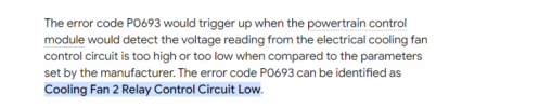

ODB scanner shows errors P0693, P2603.

Shorting out as it blowing the fuse ?

I've found out that if I disconnect the electirc turbo coolant pump then the fuse stops blowing, so it looks like a faulty electric turbo coolant pump.
New one on order, should arrive Monday/Tuesday. Fingers crossed that will solve the issue once and for all.
