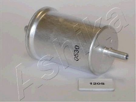

I got another test done and it’s the Fuel Filter that needs changed. I have just ordered a fuel filter. I have tried to see online a tutorial video for changing it but I can’t see any I can’t even locate it in the engine bay, I’m wanting to do it myself as the garage can’t get my car in until the 18th! can anyone show me where it’s located and even better if there’s a video out there of the fuel filter being changed!

They were only fitted to "Grand Export Versions to Tropical Climes" according to Peugeot Data aka Dusty deserts somewhere in far off climates?

The only other one detailed is in the Tank & its the "Pick Up" or low pressure pump?

Jesus this car is hard work. So can you recommend what part I’m needing ? Attach a link?

I would suggest that you have a competent Mechanic check the HPFP before condemning it. It sounds like neither you have tried so far are good.
If your car has a fuel filter its either as Pedro has shown or here.....

Well the second diagnostic reading that was done the mechanic said it’s come up as the fuel filter is the problem. I told them I’ll get the parts I need and get the car back into them when there is a slot.
So after hearing the car doesn’t have a fuel filter lead me to the other common problem and reading the symptoms of a high pressure fuel pump it sounds similar.
I did find a fuel filter for the car for sale on eBay but now unsure if that’s only for other country RCZ surely someone must know if the UK RCZ’s came with a fuel filter or not?

U.K. RCZ’s only fuel filter is in the fuel tank and is part of the low pressure fuel pump as Pedro has pointed out.
If your HPFP is faulty, you should be getting error codes. You should also be experiencing limp mode, misfiring, etc. This can be intermittent with a failing HPFP.
You have not said if your car is having any problems, only what various mechanics have told you is wrong.

The problems are going into limp mode, on cold start up feels a bit jittery for a couples seconds on take off, then once warmed up the engine light sometimes goes off and power returns or the light stays on and power will return. It cut out on me straight away once I started it up on 2 occasions but it hasn’t done that for a few weeks now it normally starts ok. The exhaust is giving out strong petrol smell.
