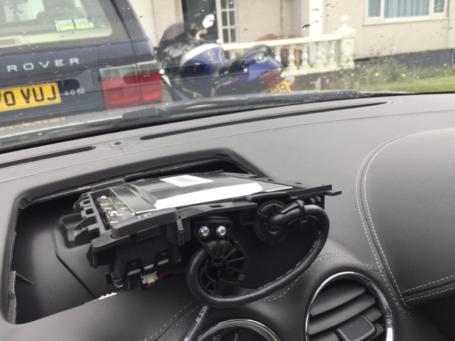

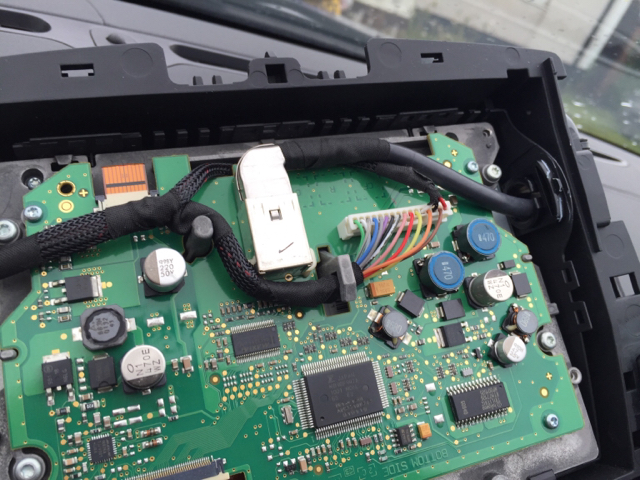

Had a flickering sat nav screen. Took the screen out and it was obvious where the fault was. The cable twists each time the screen opens and a wire was broken. Took it apart and soldered in a new section. If anyone wants some cable to repair their own foc,just pm me and send a sae. Had to buy 50 meters but only needed 1!!
Hi, your post on the sat nave problem is illuminating. I think I have the same problem. any chance you can give me a clue as to how to remove the unit to check? Then I feel sure that i'd want to buy some of your spare cable
