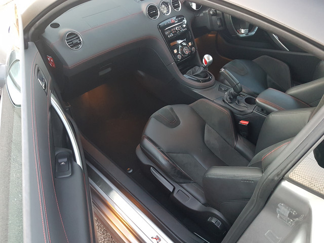

I had bought the stereo for another car after picking it up in the sales. I decided to shoehorn it in to the R. I really wanted Android Auto as it adds a lot to a car.
The dash is too far away and I thought it wouldn't be that bad an idea to do with the single din retractable unit to come an inch closer.
It does hide the buttons when the screen is open, but I knew that was coming.
Just a few pictures of the headunit.
