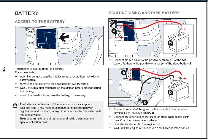

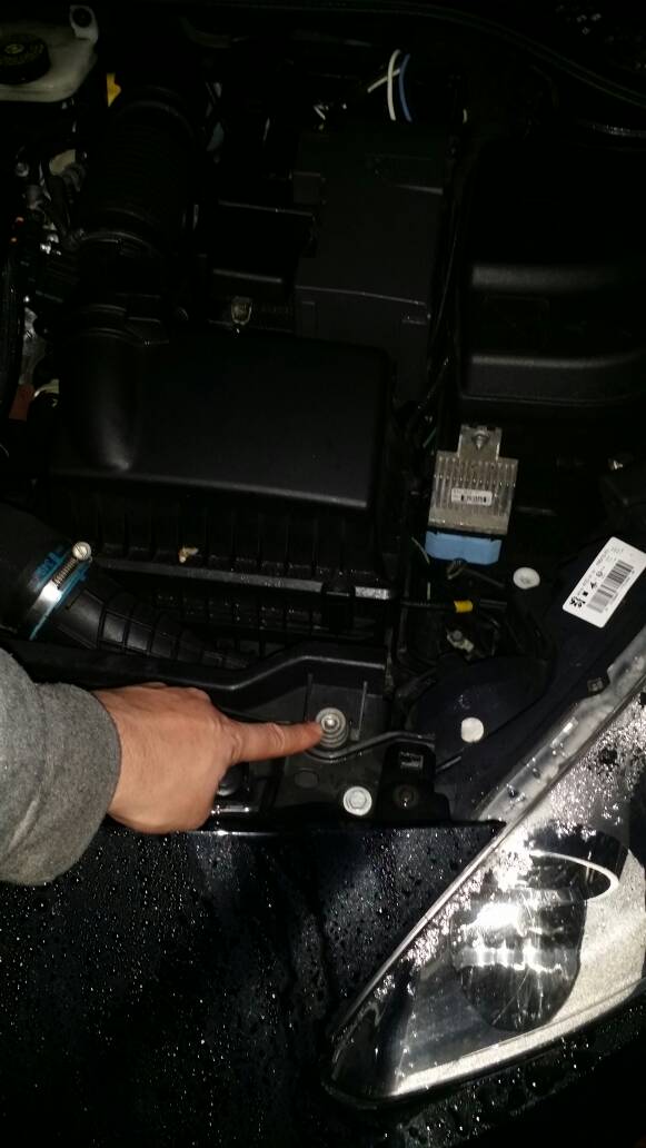

From the manual there is a negative terminal near the radiator.
Jul 26, 2015
256
It's covered by a million pieces of plastic/wires and guarded by 3 dragons, to stop you using it and screwing the Ecu up apparently.
Point C on the bodywork replaces it. The bit that messes with your head is when you jump a Z with another Z and have 2 point C's and no negative access.

The starting procedure in that case is.....
Park at the top of a reasonably steep hill, turn on ignition, engage 2nd gear, depress clutch & release handbrake. At @ 5-10 mph, release clutch, smile, & drive into the distance ;)
:crazy:
But that's the point.
Point C is connected remotely to the negative of the battery.

The starter motor will be earthed to the body, via an engine earth strap, then the body earthed to the battery.
In actual fact, earthing the external 'starter' battery to the point indicated in the diagram is probably equivalent or perhaps slightly better than attaching directly to the negative terminal of the battery. Don't forget also that the cables used to connect the external battery to the car (jump leads) also introduce losses.

I think that his point was that he thought the donor battery had to have jump leads connected to the actual terminals, regardless of where they attached to the dead car.
The point Chris is making is that you only need the positive lead battery to battery, if it's a Z starting a Z, point C to point C is fine for the negative lead.
At this point the OP will probably jump in explain that's not what he meant at all ;)
