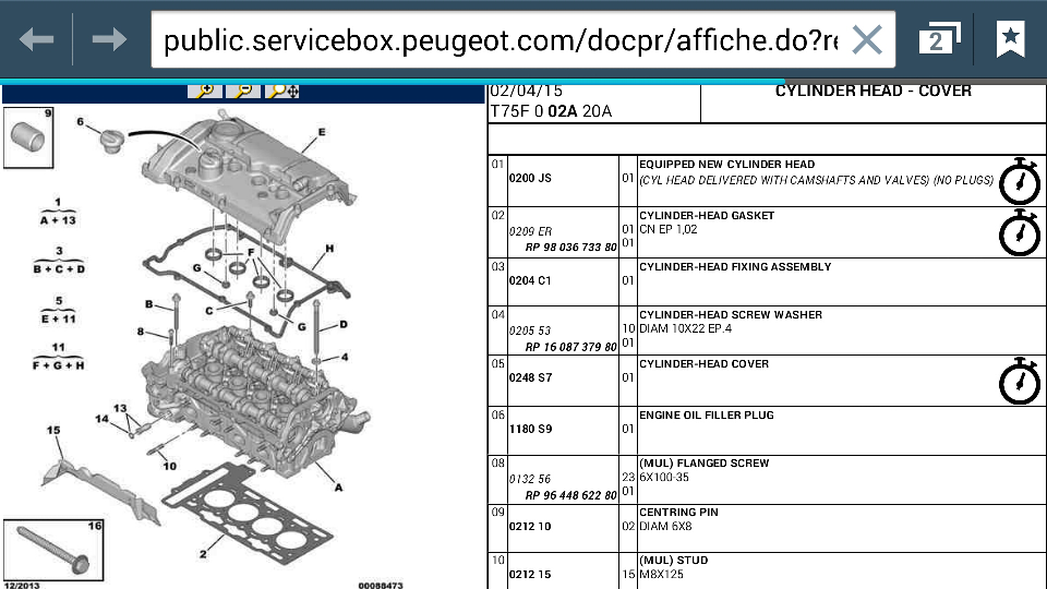

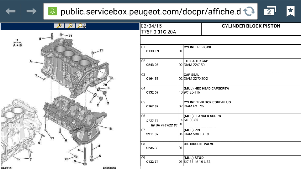

It doesn't look like they are sleeved as I can't find the parts.
