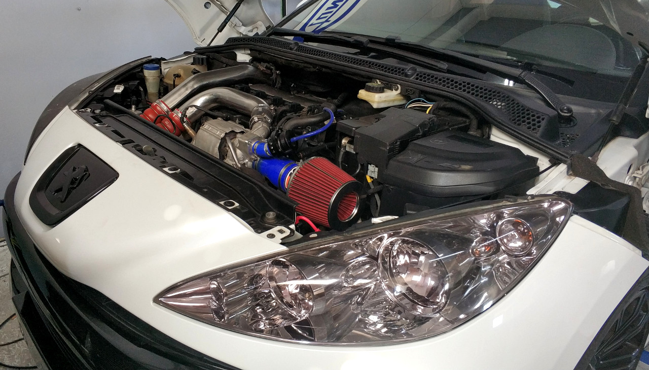

hey guys !
recently i bought the 156hp and i love it , thinking about buying a bigger turbo to get some more power.
has anyone tried putting a bigger turbo ? any tips? i found this turbo on eaby (click here to see).
according to them the only mod that is required is
Intake system needs to be modified as cover inlet 50.3mm which is larger than factory 45mm.
lets say ill take to a remap so it would be around 250~ HP with the bigger turbo, would i have to reenforce the engine ? or would it be able to endure the extra power ?

Remap, or hybrid turbo + remap,
Brakes, suspension, intercooler etc. all needs to be changed
Larger turbine will make bigger lag, try to get turbo from 200 THP, its dual scroll as is on R

If i was you id buy this Peugeot Citroen 1.6 THP 150 155 163 EP6DT Billet upgrade turbocharger STAGE2 | eBay
The turbo you want rated 320hp so not really worth it unless you want more power than 250 but then might need to forge
